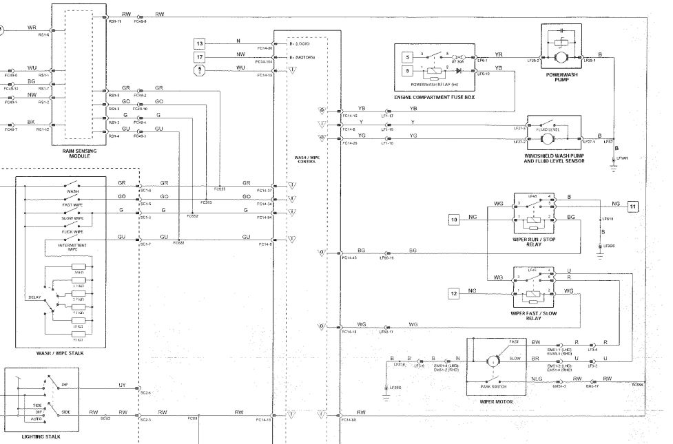

    Figure 14.1 shows the whole Wash/Wipe system. The powerwash pump (top right) is permanently connected to ground by a brown wire. (right hand side). So - the 12v + feed must be from the YR (yellow & red) wire which comes from the powerwash relay. This has two square boxes, so permanent 12v positive supplies from somewhere called '5'. The ground supply comes from the Body Processor module with the YB wire. A relay is just a switch operated by an electric magnet. The switch part is at the top - after the switch there's a fuse - and the electric magnet is the rectangle below.
    The diagram also gives pin numbers for all connectors, and if you loook in the front section, there';s a detailed description of each connector (e.g. yellow 22 pin or black 6 pin) and also where to find it.
    So - zooming in a bit on that section, for the pump to work, there should be a permanent 12 volt positive supply on both pins 3 & 1 of the relay, and if you unplug the relay and bridge pins 3 & 5 the pump should work. If it does - the relay is at fault, or ......... there's a problem with the body processor module not supplying a negative feed to the relay when required. If it doesn't, the pump is faulty or the fuse has blown. The fuses are numbered, and the numbers - difficult to see - are etched into the plastic in the various fuse boxes.In either case, it is also possible that the ground / earth wire is not making proper contact, but that's easy to check with a test light or multimeter set to ohms or continuity.

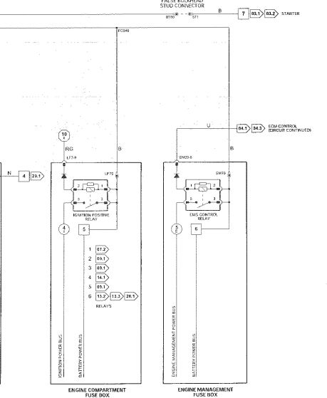

    So - I hear you say - what about the 5s in the squares ? Well - if you look at figure/page 01.1, you will find the main power distribution diagram, and can see that the 12 volt positive starts with the battery, goes through two high power protection fuses (in the boot next to the battery) and then to the 5 fuse boxes in various parts of the car. 5 in a square is the engine compartment fuse box and you can see that one of the places that 12v goes to is figure/page 14.1 - the wash/wipe system page. (That's the six sort-of arrow rectangles which all indicate different figures / pages.)
    You can also see that the same 12 volt positive goes to both the coil and the switch of the "ignition positive" relay - the negative for the coil is from 10E (in the octagon) the ECM, - in other words - that relay is grounded by the ECM and when energised, supplies 12volts positive to 4ll when the ignition is on.
    If you were to go to figure/page 01.4, you can see that 4ll supplies power (12v +) to fuses 1 to 5 in the engine compartment fuse box, which then supplies fused 12v+ (when ignition is on) to various other places in the car.
