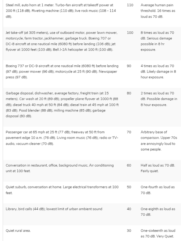

    I'd initially checked db readings and it was coming back at around 56db min, 83db maximum with an average of 76db, see chart below for comparative db ratings
