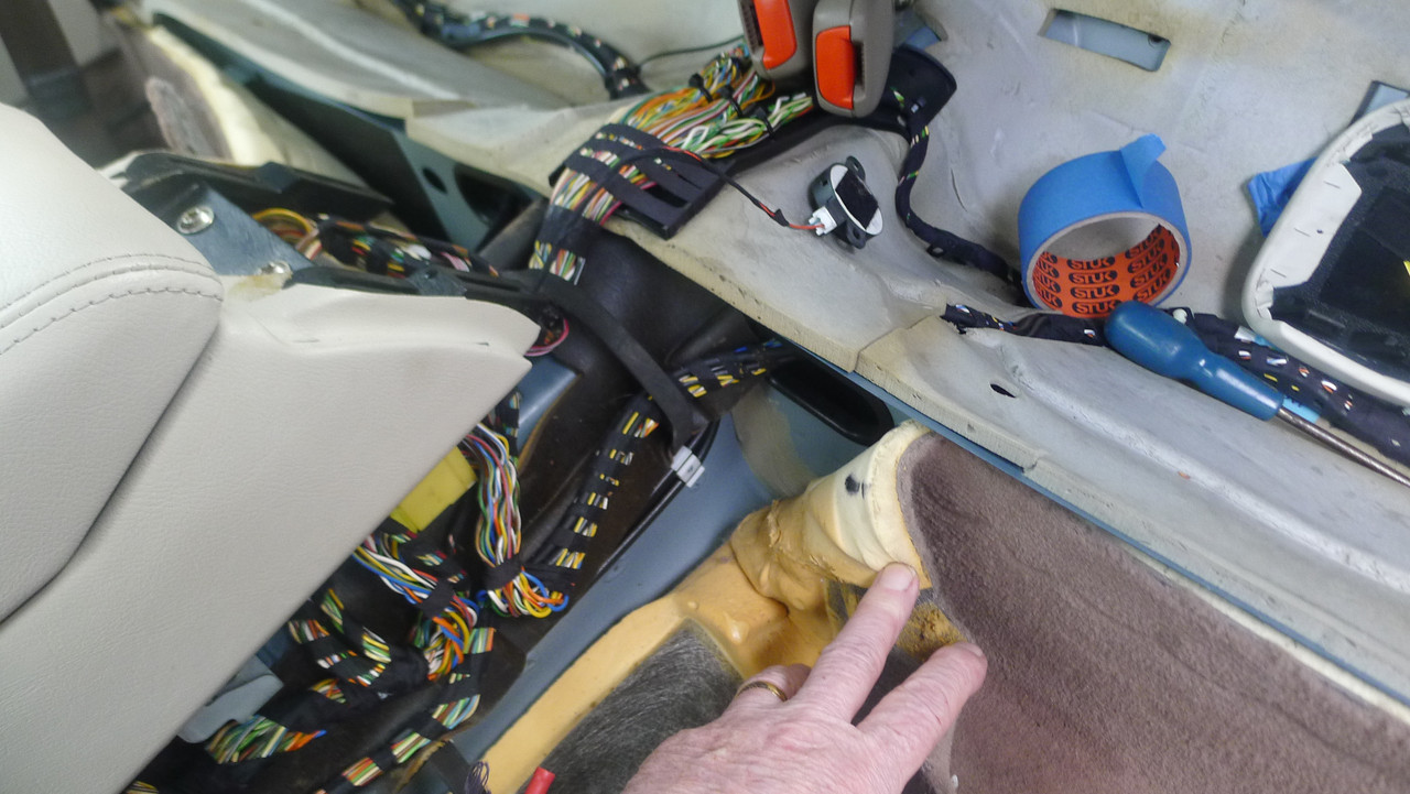

    Quote Originally Posted by Nerja View Post
    Can anyone who has done this explain why it is necessary to follow the path the original hoses took? It seems like a huge amount of work to achieve something quite straightforward.
    Could the hoses not be routed under the car or inside the car along the transmission tunnel and across?
    You could be a nightmare if you did. They say a picture is worth a thousand words......... hang on whilst I dig one out for you. The wiring gets worse further down too.
    Basically there is a whole mess of wires in the centre console. I spent 15 mins just tying up loose bundles of wires with cable ties. Then if you make it all the way to the front you would have to contend with the problem of routing it from the front centre to the side. Not only that if you did manage to squeeze it in there no doubt something would break loose and you would probably only find out when you have put it all back in. Also the hoses themselves are sized to go that route. Imagine fitting it down the centre only to find is 1/2" too short at the other end.
    Any other questions dont hesitate to ask.
