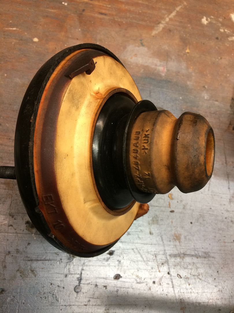

    Quote Originally Posted by plc View Post
    the yellow item is the bump stop, it will move up and down the shock ram as its not fixed in any given position, you have a rattle the bump stop is plastic it wont rattle,
    Having removed the shock absorber, I have found that the yellow bump stop should be fixed inside the top mount and not be bouncing around on the spindle.
    Here it is in its correct location.
    I cannot believe that the floating shock absorber can create the sort of rattle I am chasing though despite this which is worth a read:
    https://l.facebook.com/l.php?u=http%...hzX40BWFGs1dQc
    I think I will take a saw to the shock this morning and investigate the internals for something loose or broken whilst waiting for the new shock to arrive. UPDATE. I have been advised not to attempt this by my learnéd pal Gary and Bilstein service dept.

    New shock arrived and was duly fitted so I tentatively went out at 17.30 to attend a Supercar Soirée in Essendon which is only 5 miles from me.
    The car did feel slightly different to drive in a good way and I am pleased to report that
    THE RATTLE HAS GONE.
    It has been good week for me, despite the rain. On Monday I finally sold the XK and yesterday I stopped the irritating rattle. Hooray.
    Jag seem solid now and is a joy to drive. It didn't even rattle over small speed bumps last night at the Soirée.
