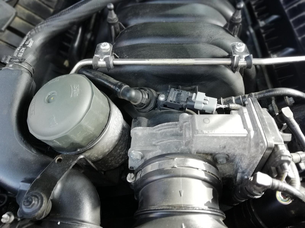

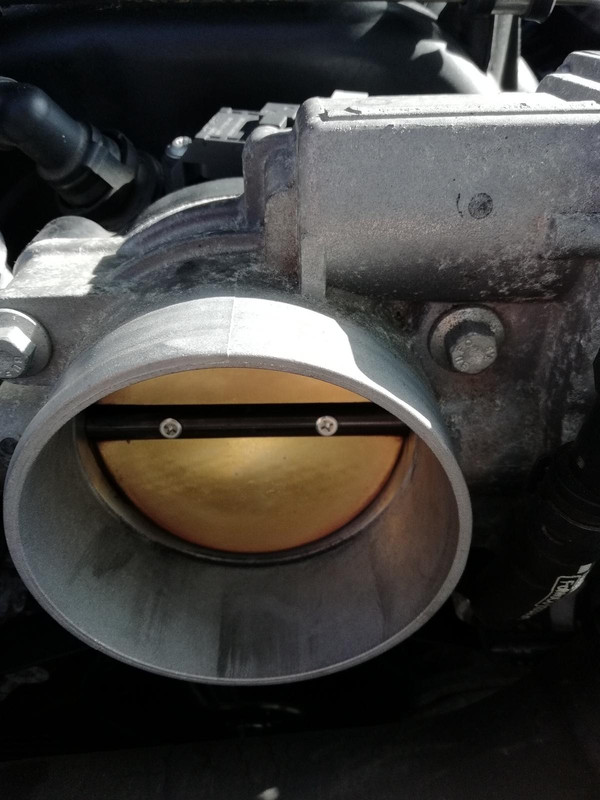

    On Saturday Rich kindly read the codes for the engine light on the dash. They were P0106 and P0101 which basically means air leaks to the MAF and the MAP sensors.
    So as a precaution I tightened all the clamps and checked the tubing for cracks.
    While I had it all apart I cleaned the throttle body
    The top photo shows the throttle body with the MAP sensor to the right of the oil filter.
    2010 Jaguar XJ V8 Portfolio.

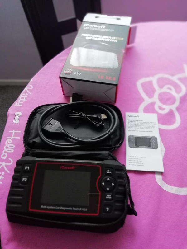

    Well since Rich is showing what he got from the postman today, here's what I got.
    It's the icarsoft lr v2.0, so all I've got to do now is learn how to use it.

  13. #137
    12,660
    Just plug it in Steve, it’s pretty much self explanatory.
  14. Thanks #steve thanked for this post
    Likes Ashanti, C16RKC, #steve liked this post

    803
    Thanks Jim, I have been looking on you tube and it looks pretty easy. Cheers.

  17. #139
    7,889
    Good call Steve, very handy little tool
    I used mine on Peter's X type recently for parking sensors, we were pretty sure which ones it was and the Icarsoft gave positive confirmation

  19. #140
    803
    Cheers Jim, I will be using it today and the first job will be to turn off the service message.
    It also does ABS bleeding which I will check out.
    Edit : Well it must be simple to use if I can do it.
    I've just erased the 2 stored codes and reset the service message.
