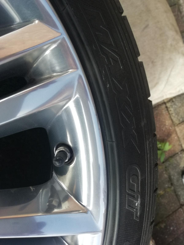

    Today I was quoted £200 to refurb a polished alloy wheel so I thought sod that and have a go myself and get it done properly when it's scuffed really bad.
    diesel gas near me
    Here is the scuff before I started.
    I used Dremel bits in a drill to smooth out the worst and then 400 grade wet and dry paper right up to 1200.
    Once it was smooth I polished it with Solvol Autosol and sealed it with lacquer.
    Here is the finished wheel, not perfect but good enough until it gets scuffed badly.

    Excellent effort Steve, you really have to look close to see it.

    Looks much, much better. Most would not even see it now.
    Some of us didn't notice it in the "before" picture.

    Cracking job Steve, result!
    You've just saved £200, what does that buy, set of mud flaps / remap or AN Other?

    Thanks for the nice comments. I'm chuffed it turned out as well as it did.
    Chris, that wheel really is bad but fixable.
    Jim, it will pay for AN Other 2 tanks of fuel lol

    Great job Steve, very impressive and a credit to tenacity and the unwillingness to spend brass.
    Did the damage happen recently as I don't recall noticing in Blackpool.

    Rich, if it had been a lot of damage I would have had it done professionally.
    The wheel was like that when I bought the car.
