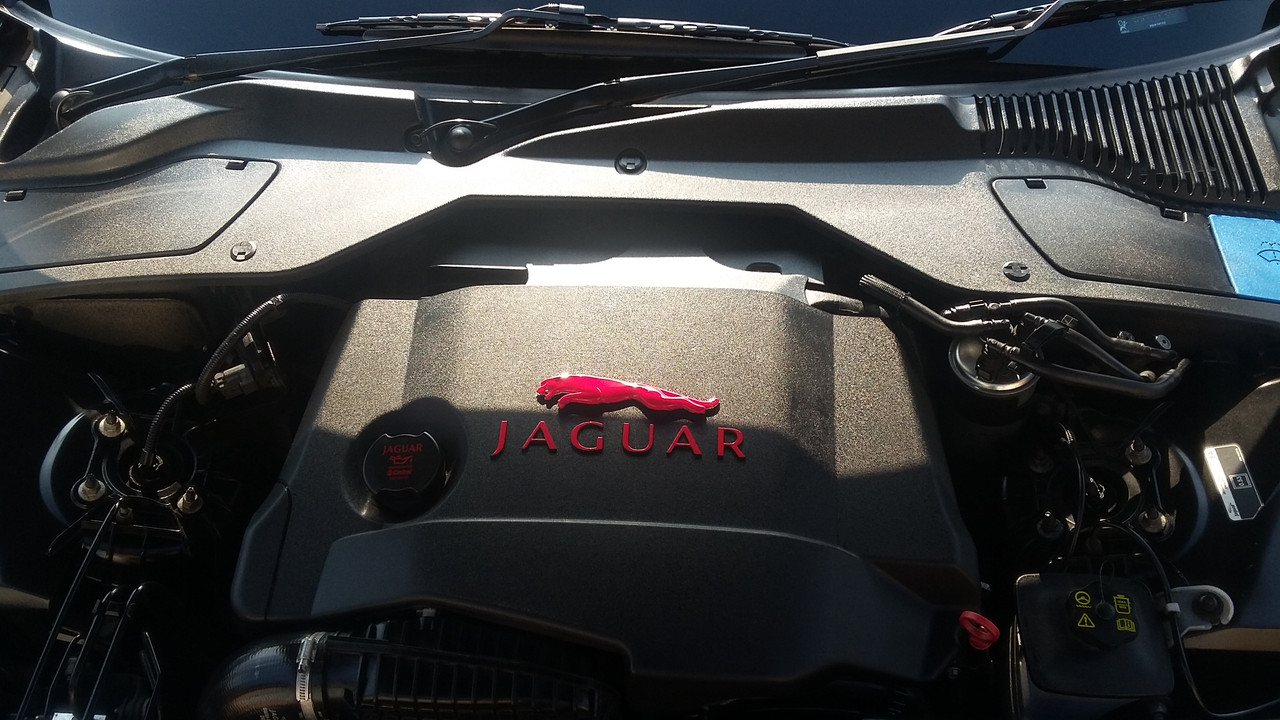

    Here's my old X358 engine bay

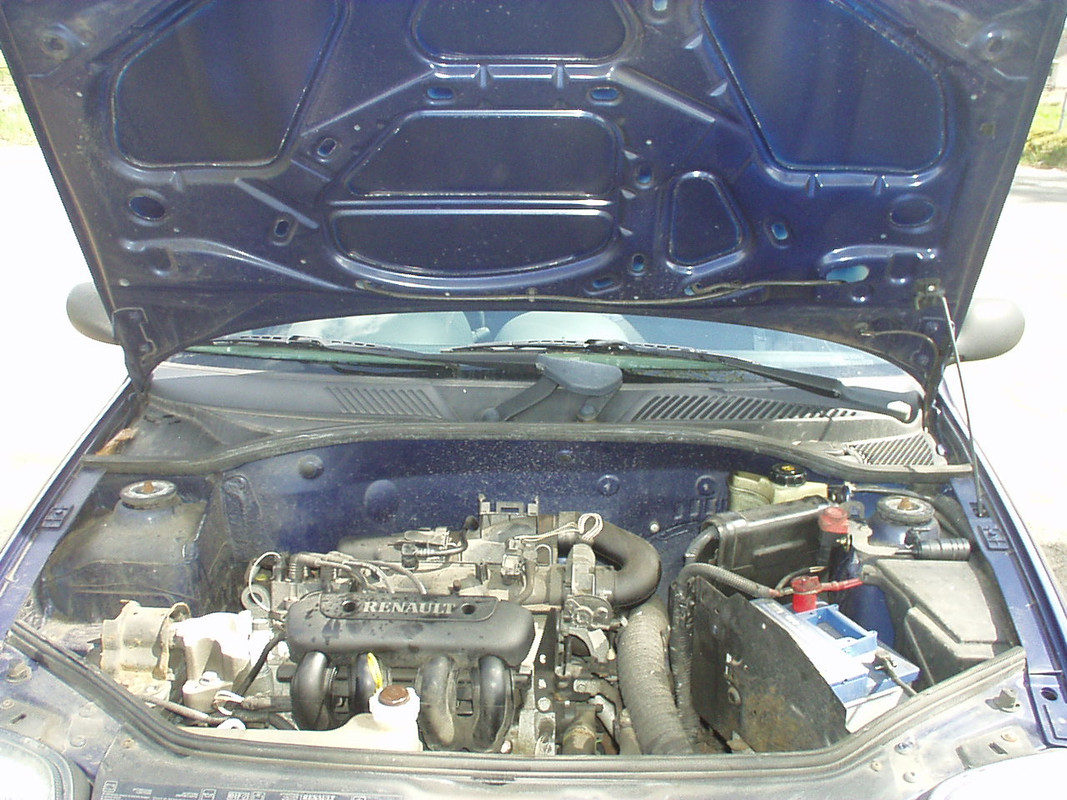

    Better still, a quick before and after on my sons old Renault Clio from some years ago, big difference
    Before...
    After....
    I found that by working inwards to outside worked best and so started by firstly cleaning the underside of the bonnet
    Then cleaned the depths of the engine as far as I could reach, working upwards and outwards
    Spraying and then agitating with the brush to get into all the little nooks and crannies, wiping with the rag and then drying off, working upwards and outwards.
    Once all the cleaning / drying was done it was a simple case of spraying the Autoglym vinyl and rubber on the hoses and black plastics and working in with a sponge before a quick gentle wipe over to remove any excess
    Probably take around 1 and a half to 2 hours maximum, then stand back and admire your handiwork
