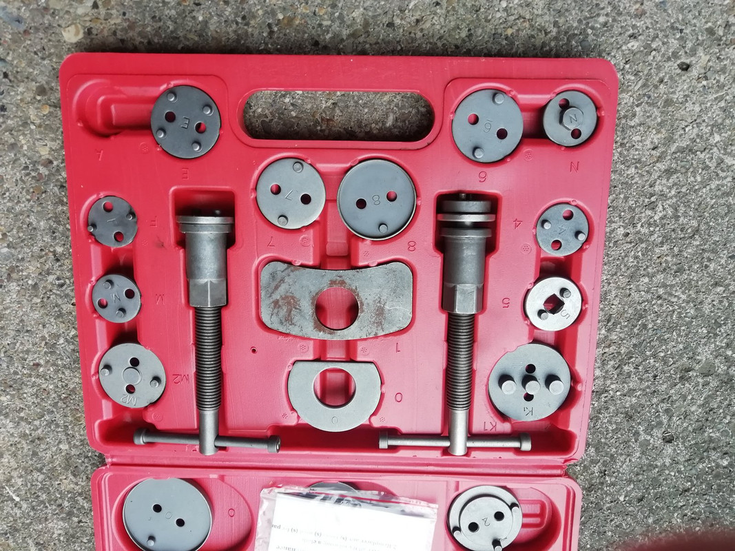

    I bought this kit off eBay which has both left and right tools.
    Also, the indents in the piston are oddly spaced and the correct part is in the kit.
    Edit, it is the clockwise tool.
