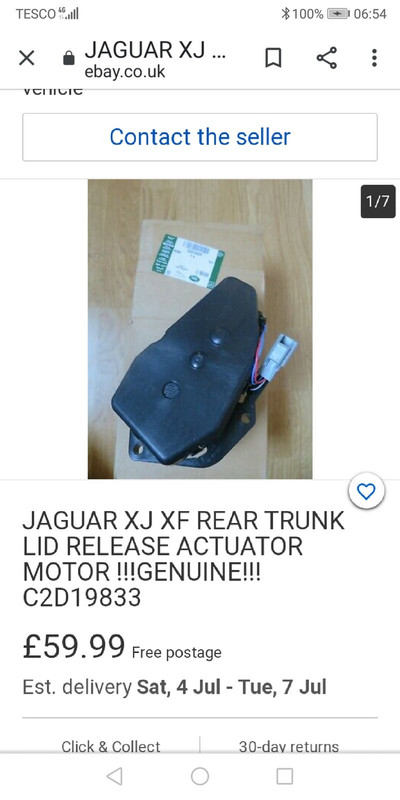

    Hello and welcome. You might need one of these.
    Take the car to a Indy to check the electric motor.
  7. Thanks Jaguar XJ thanked for this post
