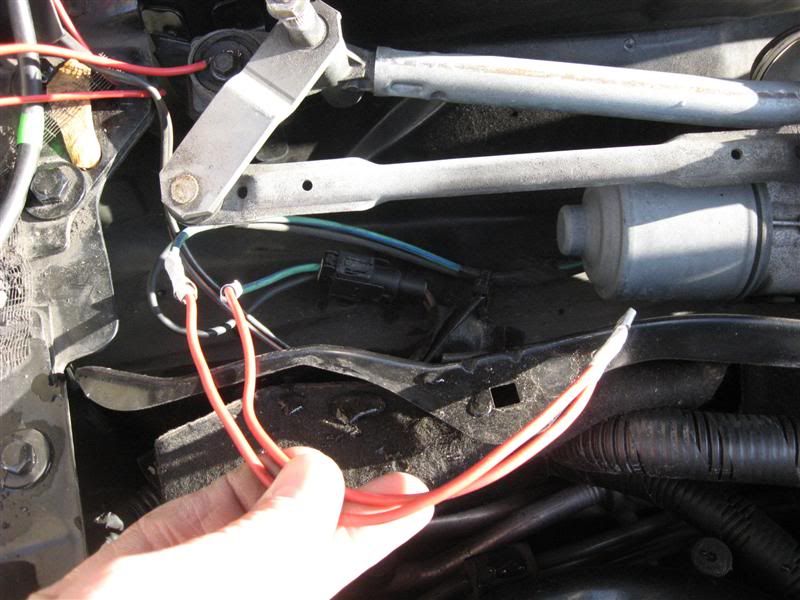

    Cut off the connectors and join one of each together to wire them in parallel.
    Now, just to clarify these pictures, I only had red wire. Ideally I would use red for live and black for earth...

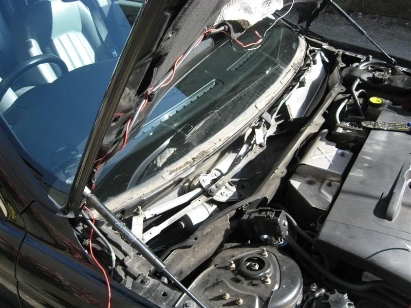

    Remove the cover under the wipers, and route the new cables to the offside of the car

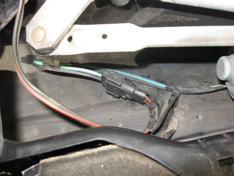

    Locate the offside heated screen wire (green/blue) and cut it.

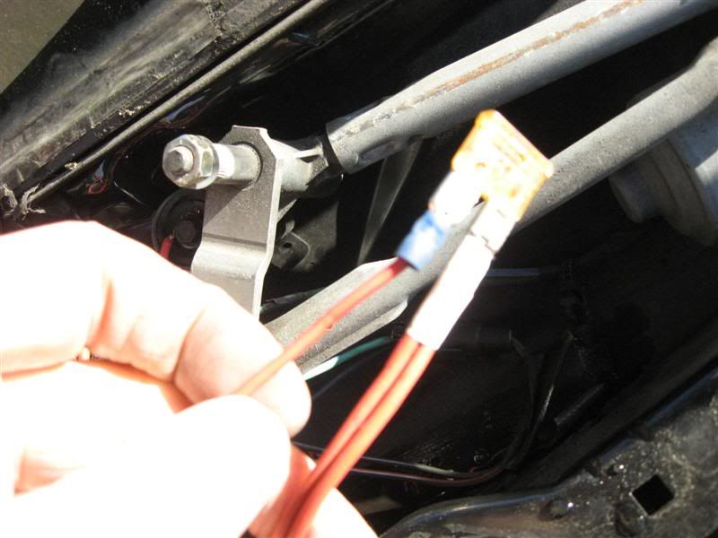

    Bring these together into a female spade connector

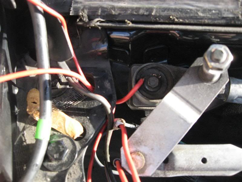

    Bring one of the heated jets wires down to earth. I used the wiper motor mount point (for speed) but you can probably find something more suitable.
    On the other heated jet wire, attach another female spade.
    Between the two spades, now insert a blade fuse. I used a 5 amp one ( heated screen fuse is 30 amps)

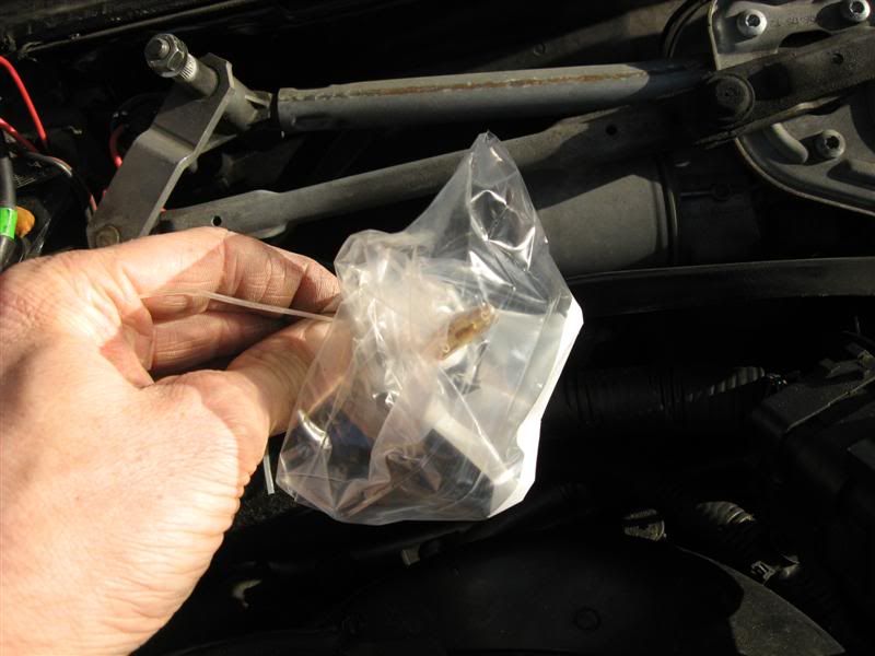

    I then wrapped both spades and the body of the fuse with insulating tape, and sealed in a plastic bag. I left the end of the fuse visible so it was easy to see if it blows.
