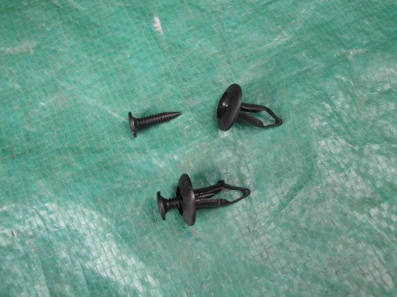

    Inside the boot, remove the plastic covering to the locking system and the pulldown handle next to it. The pulldown is held with two torx screws but the cover uses these plastic fixings that easily distort.
    Use very light pressure on the screwdriver as these screws will strip even when undoing them! If all else fails, they can just be pulled out and replaced with new. Then remove the locking motor assembly held on with these three torx screws, remembering to mark the position of the lock to allow it to be replaced in exactly the same position later.

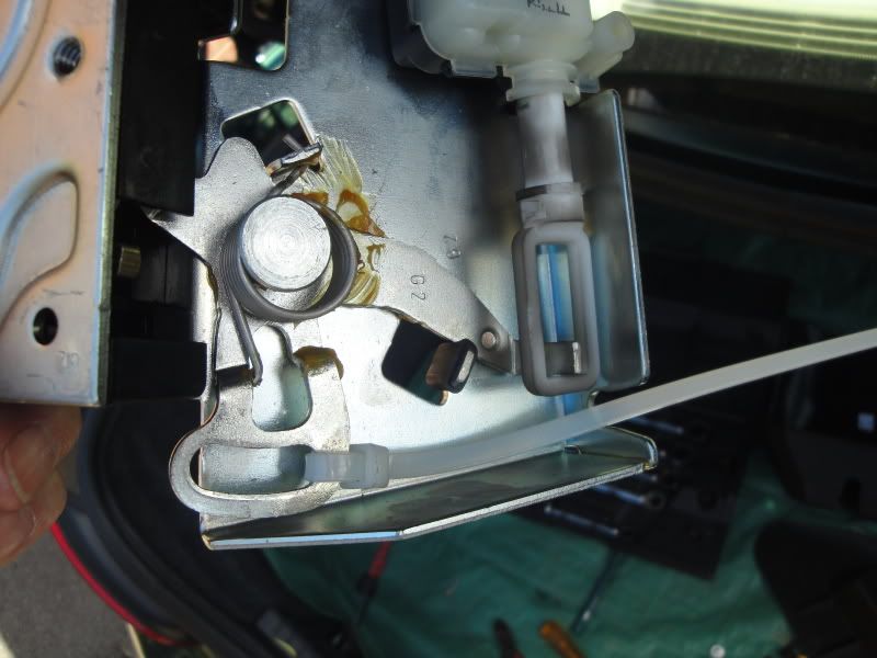

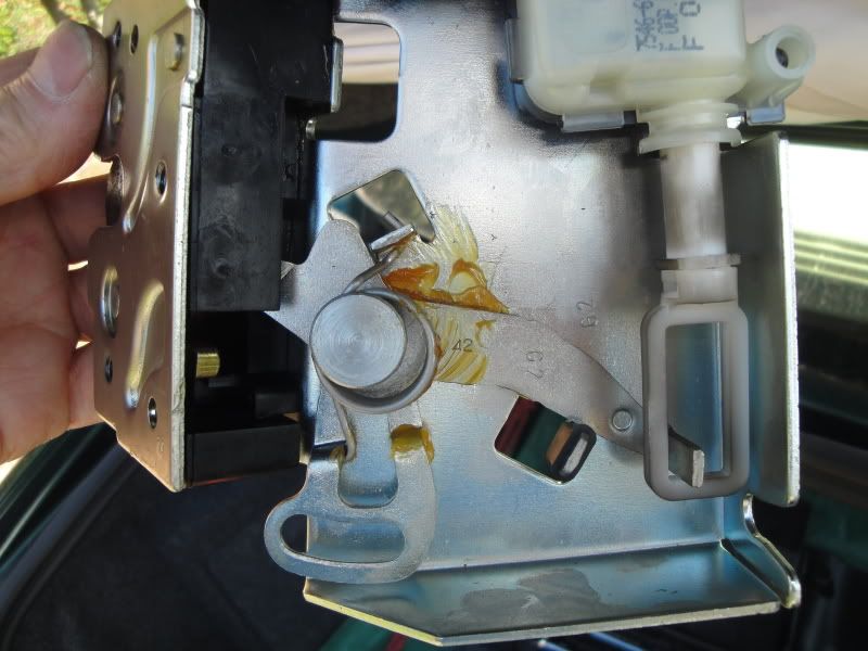

    You should now see some of the internals as shown here
    Attach a 10 inch long tie wrap as shown here to the arm that I think is used in the US spec to allow an internal operating pull to be attached, to allow trapped children to escape! The knob has to glow in the dark! Note the plastic lock cover has an opening for this. Anyway, it’s just what we need for this project.
    Now feed the end of this tie wrap through this hole and replace the lock assembly.
    Remove the number plate and you can now feed the tie wrap end through the topmost spare number plate hole in the boot lid as shown in this shot from inside
    And this from outside.
    Time now for a trial run. Pull the tie wrap end and the boot should unlock. If so, replace the number plate until emergency access is required and refit the internal boot lid trim. That’s all there is to it, but it might save you a lot of frustration in the future.

    It looks like the early X-Types have a different boot lock mechanism. My lock is only held in by two torx screws and when removed doesn't reveal anything. I assume that the child release mechanism was fitted later. My car is a Y reg but Astromorg did say that other models might not be the same as his.
    I agree about the plastic clips with the central screw. They are the spawn of the devil.
