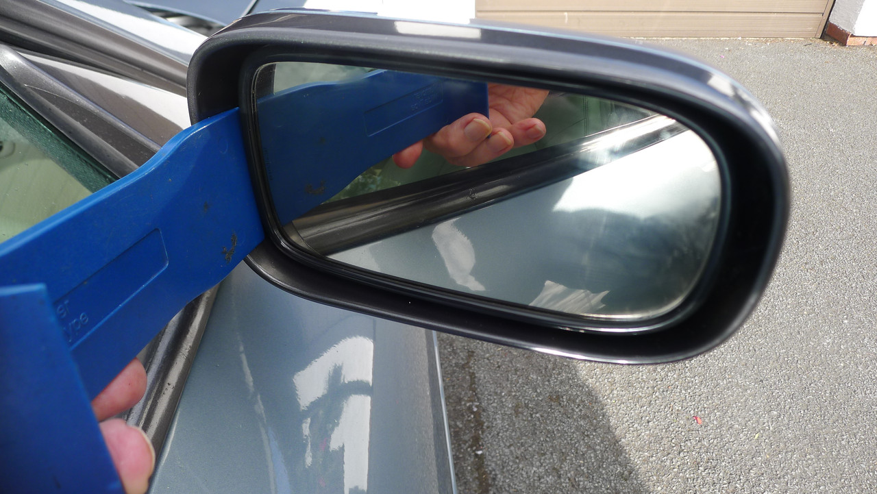

    Push the mirror in as far as it will go at the end nearest the car. Put a plastic lever behind it. At the other end with your fingers if they are tiny enough or another plastic lever apply gentle outward pressure and at the same time at the car end push along the inside edge towards the outside edge, not pry out. Its under a spring type restraint. Once the mirror has moved about 3 mm you will find the outer edge comes out/off. With the outer edge off you push that edge back towards the car to free that end.
    The mirror could be electro chromic, very expensive, so put a towel/padding on floor to catch the glass if you loose grip on it. Also do not put too much pressure on the glass as again if it cracks its useless and VERY expensive to replace.
    Once mine was out I found a loose wire! A quick pinch up with the pliers. A bit of electrical cleaner. WD40 later I put it all back together. Without a laser thermometer I cannot tell if its working again or not, but I strongly suspect it is.
    So this is the lever I used on mine. Levering it gently, you can feel it 'bounce' away from the car.

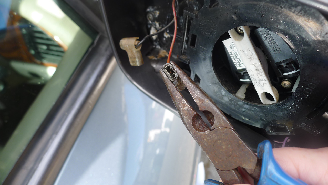

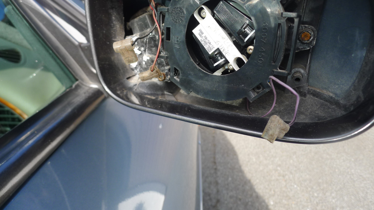

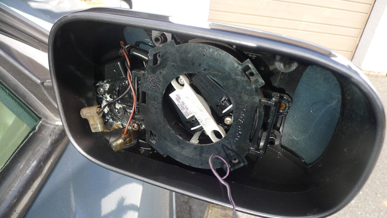

    Once the glass was loose I unplugged the three wires behind it. This is what I could see.
    One of the wires, brown bottom left, was not connected. A quick spray with electrical cleaner on all the connectors and a nipping of the loose connection with a pair of pliers would ensure it does not come undone again.
    Clean up of the inside and a spray of WD.
    To put the mirror back in place 'hook' the car end bracket first. Then push in the other end till it clicks/snaps back in. You can feel it connecting.
    With the mirror back in place, job done? Will not be able to tell till tomorrow morning when It mists up again. That should fix it though!
    Update.
    It did fix it. Went out and sprayed it with a mist of water. Need not have bothered with the water though. After a short while of running the car with the rear heater on you could feel the mirror heating up. Job's a gun un.
