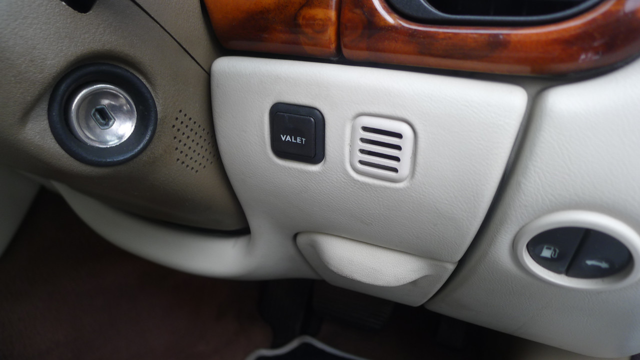

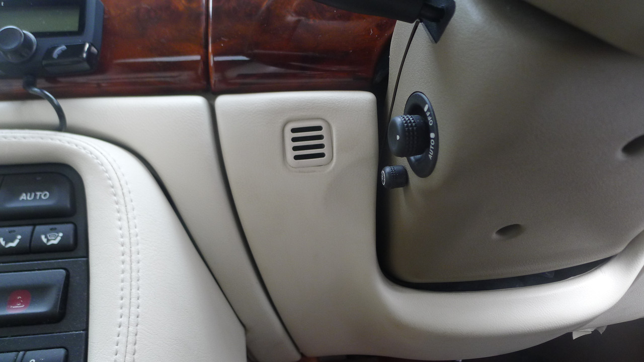

    So in front of the car are two small vents. One either side of the steering wheel.
    This one on the (uk) drivers right.
    The other on the left just above the drivers knee. Thats the one that contains the sensor.
    At first I was going to pry the vent out, bad idea do not try it. You will see why later.

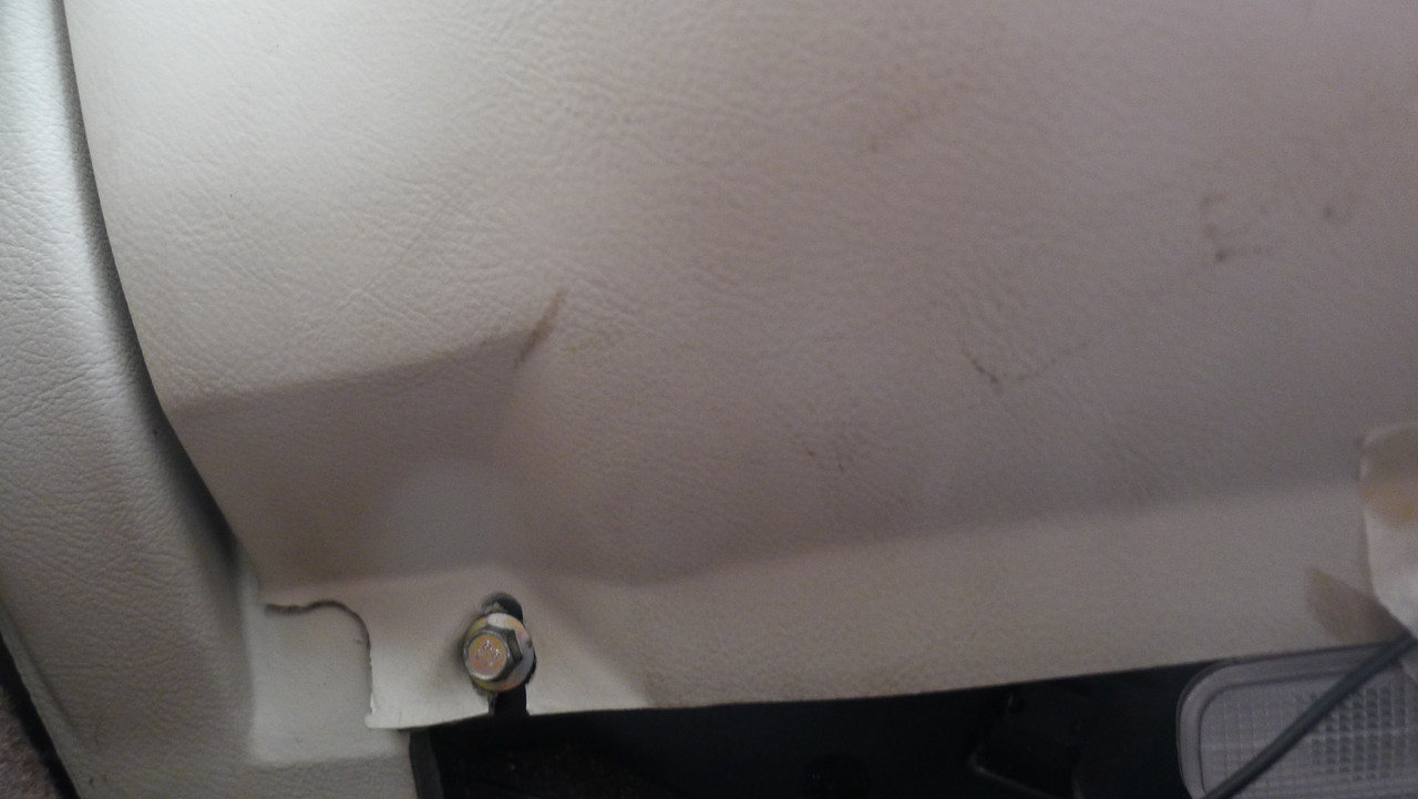

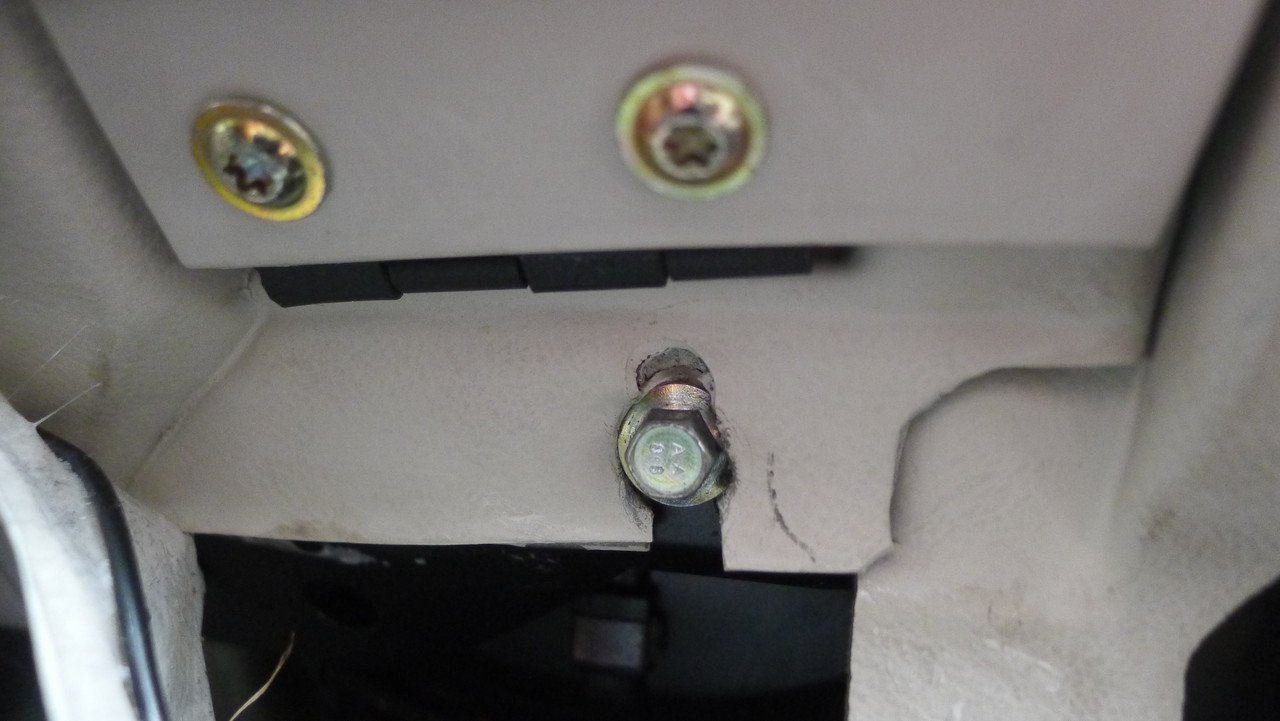

    Follow the leather bolster down and you will find two 8mm nuts, one either side.
    This is the left one.
    This is the right one, looks like someone has had this cover off in the past.
    So stick on a 8 mm socket and loosen, do not remove the nuts. ** Frank tip** I found it hard to work out, or it simply did not feel right, which direction is Loosen/tightening when undoing nuts upside down. The answer is both obvious and simple, though it did take me a while to catch on. Simply use the wrench the right way up. Set it to unscrew etc then turn it upside down to work on the nut.

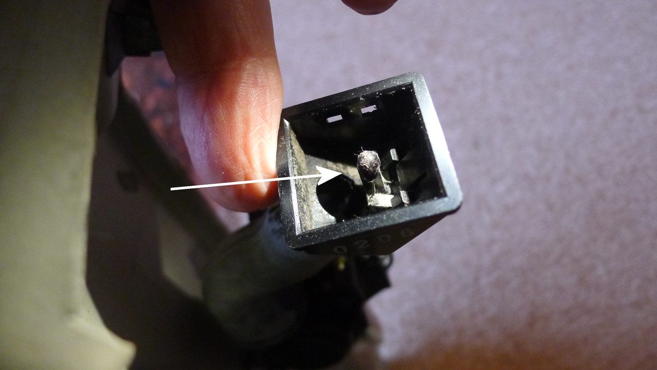

    Once loose you slide it off the 8mm bolts you loosened earlier. Unclip the two connections underneath. Make note of the position of the valet sensor connection especially the two tiny clips that go on the outside. Seems a flimsy setup compared to the other side. You will see what I mean when you do it.

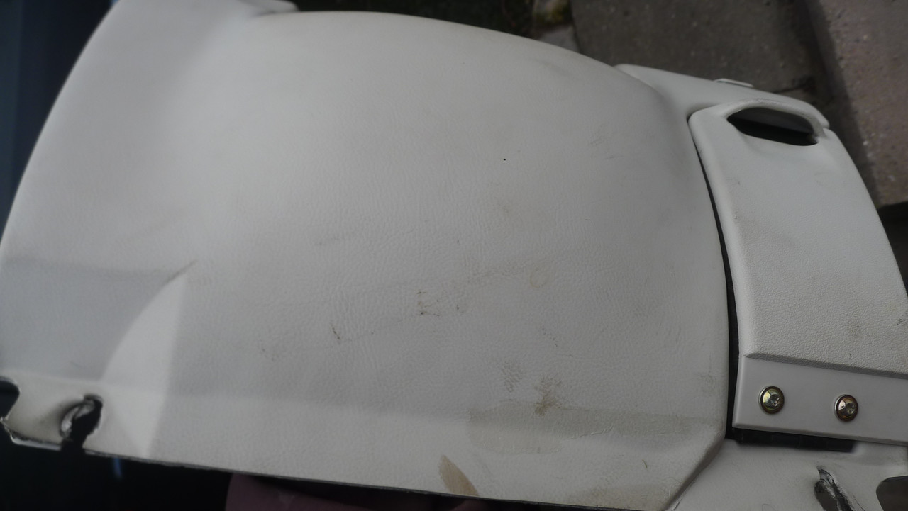

    This is my rather dirty knee bolster out. Did not actually look that bad in position.

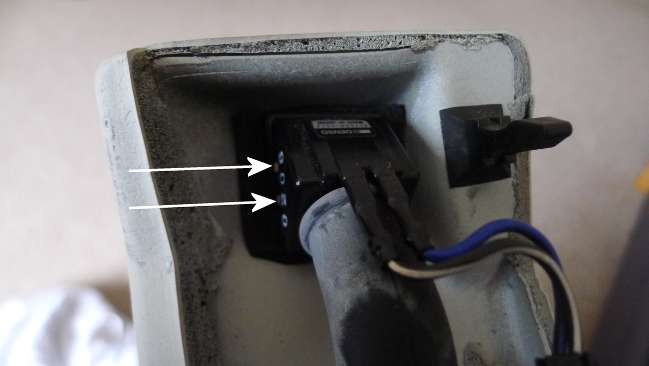

    To remove it from the exterior vent you have to push in two tiny clips either side. When I first saw them I thought it was just white paint. On much closer inspection it turned out to be the clips holding the vent in.
    This is the part I refer to above.
    Same place close up. There another two clips on the other side. They simply push in with something tiny to release.
    See why I think its a bad idea to try and pry out the vent?
    So now the cover is off the sensor. I thought mine was relatively clean, see photo below. Looks like the MAF cleaner did its job. I still took a Q tip and cleaned it with alcohol.

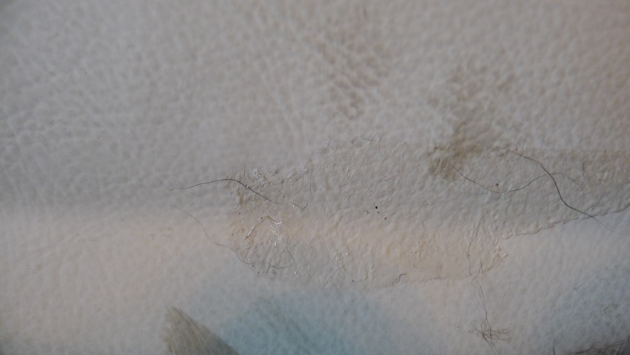

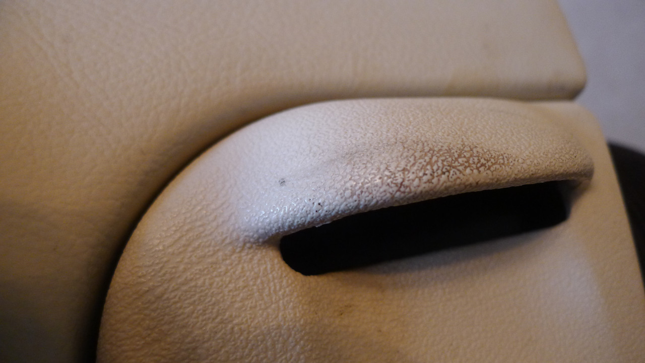

    That done I had a go at the rather dirty leather cover.
    Spent sometime on it and now its ready for refit. All clean I also tackled the rear too. The bolster is metal covered in leather, surprisingly heavier than I thought. Even rust to treat!
    So here it is done. Quickly and easily refitted. Slid into the bottom two nuts first. Reconnected wires at rear. Clips pushed back in. Tighten the bottom nuts. Jobs a gud un.
    Any detached leather can be superglued back in place.
