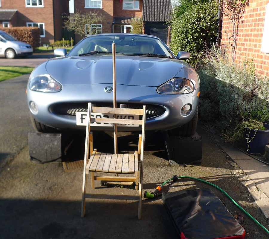

    Ramps out. Up onto ramps. Got to the front of the car and blasted underneath with a high pressure hose to remove any loose dirt, dust etc. Just waiting for that to dry, and for it to get a bit warmer. Then I can get cracking.
    So here it is up on the ramps ready for me to start work. Whats with the brush and chair? Sitting in the car you cannot see where the ramps end. So I measured the distance. Stood the brush up against the chair. So when the nose of the car moves the brush slightly I am in the right spot. Simple but effective! (Bit like me)

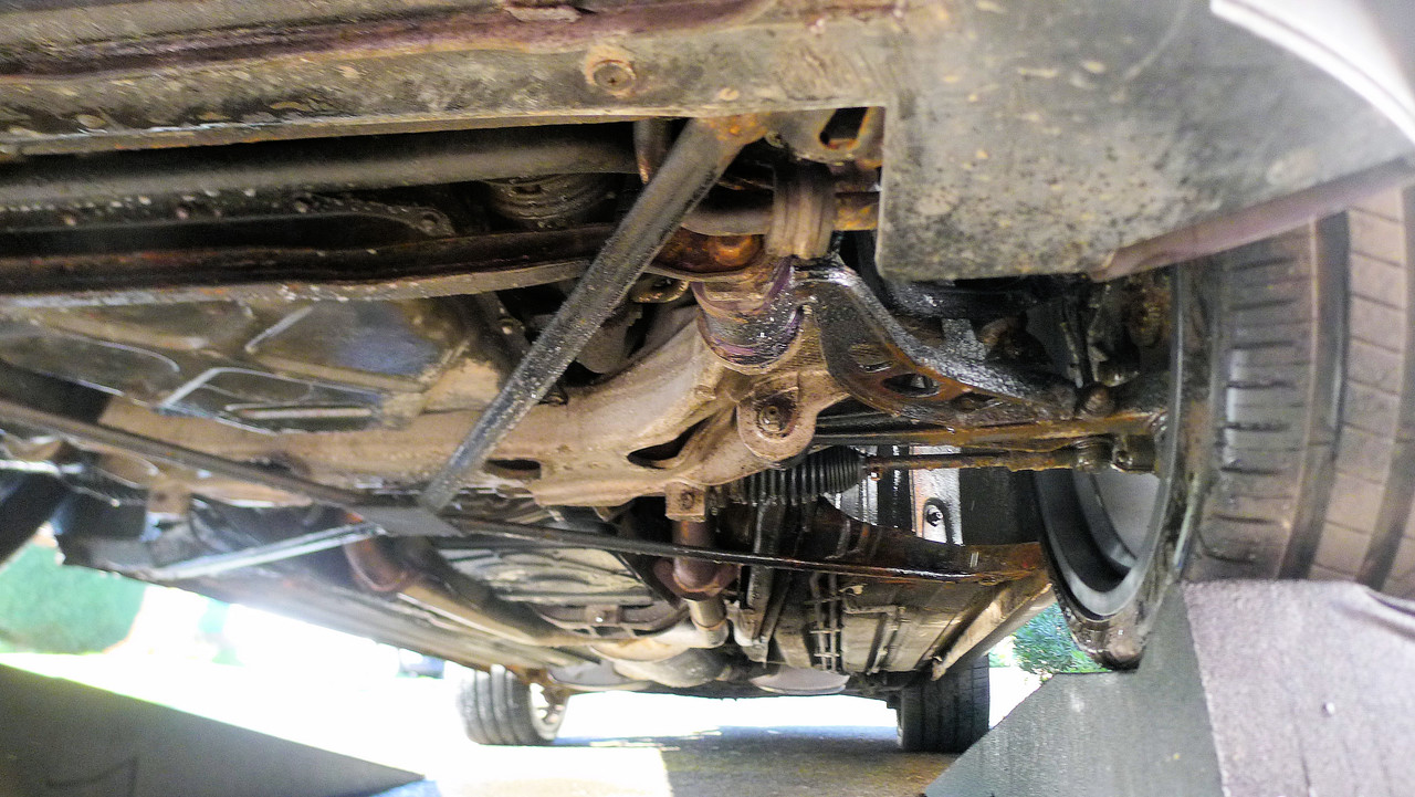

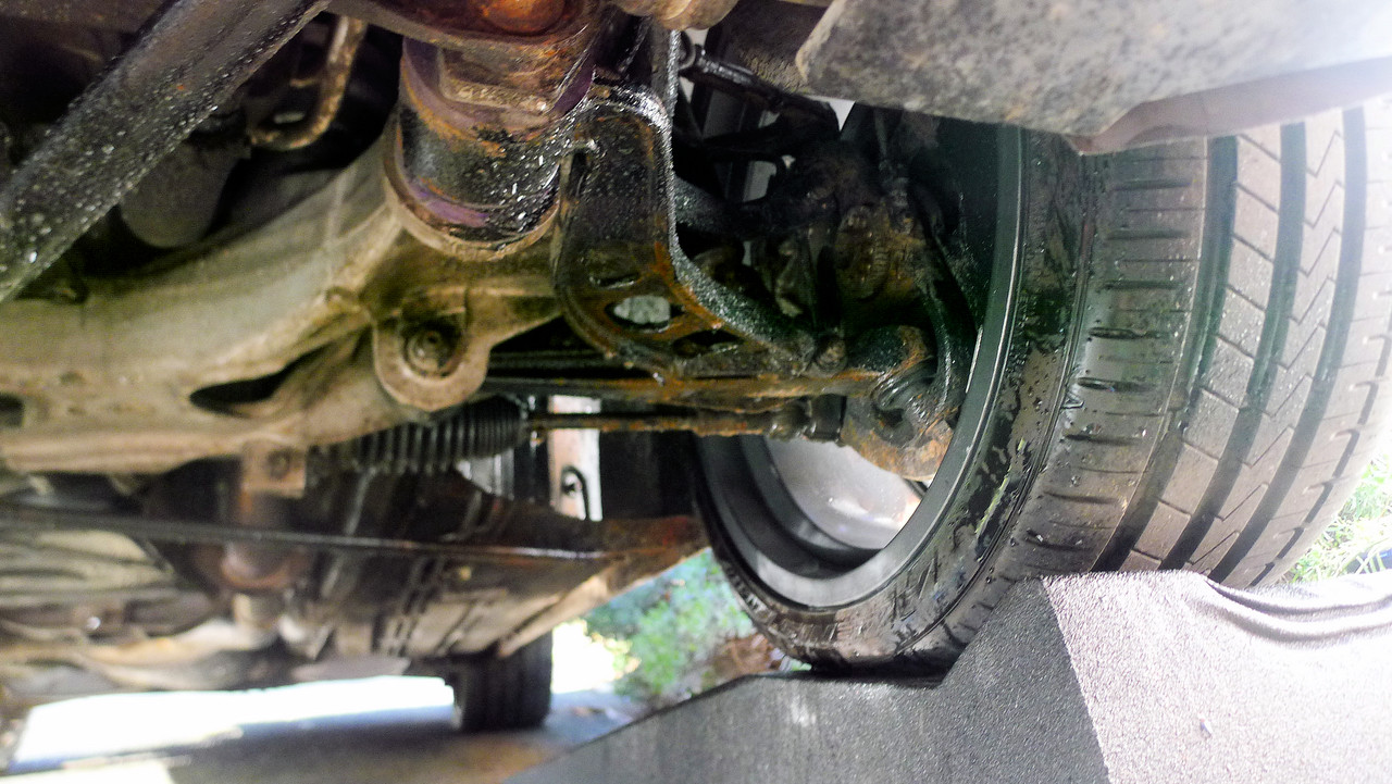

    Hosed down and dripping but you can still see the rust.
    Seeing that photo reminds me I need to remove that panel!
