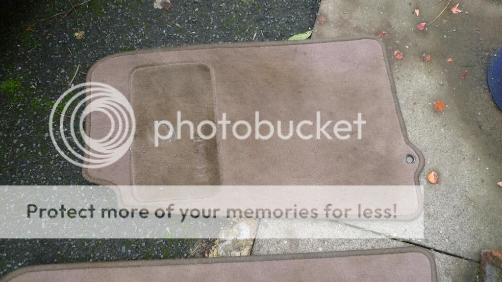

    Carpets first. Good vacuum. Took the mats out of the car. I was going to replace them but dealer says he cant get hold of replacements and if he could it would be £110+vat. So I thought whats to be lost? Give them a good clean.
    Ok. Done that. Outside drying right now. So lets put up some before's-

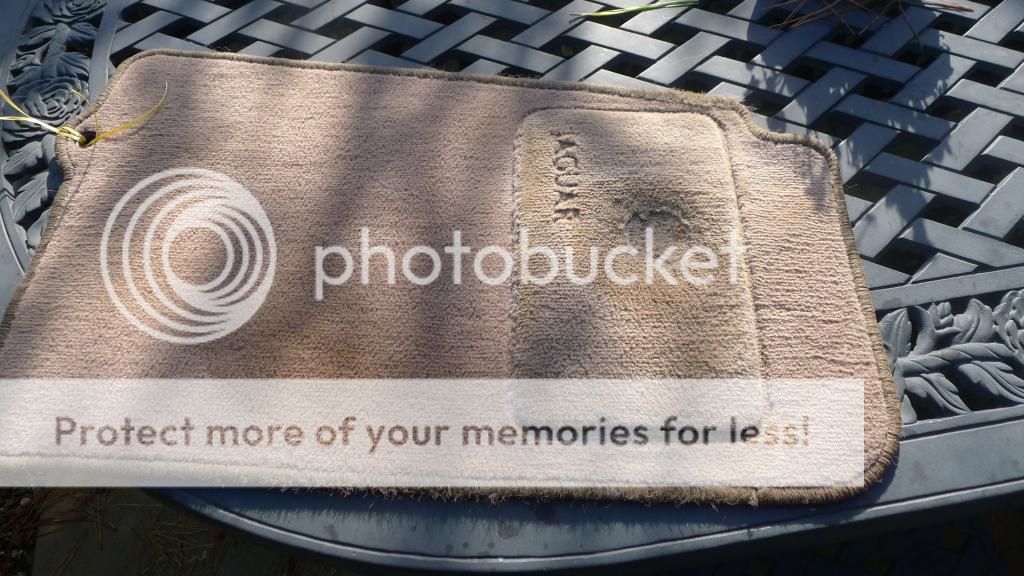

    Ok,now for the after photo. Taken in full sunlight to show its worst. You cannot really tell from the photo but I can see a marked difference.
    Oh and the bit of string on the left is what I used to hand it from our washing line.

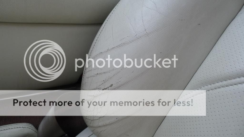

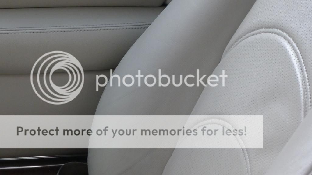

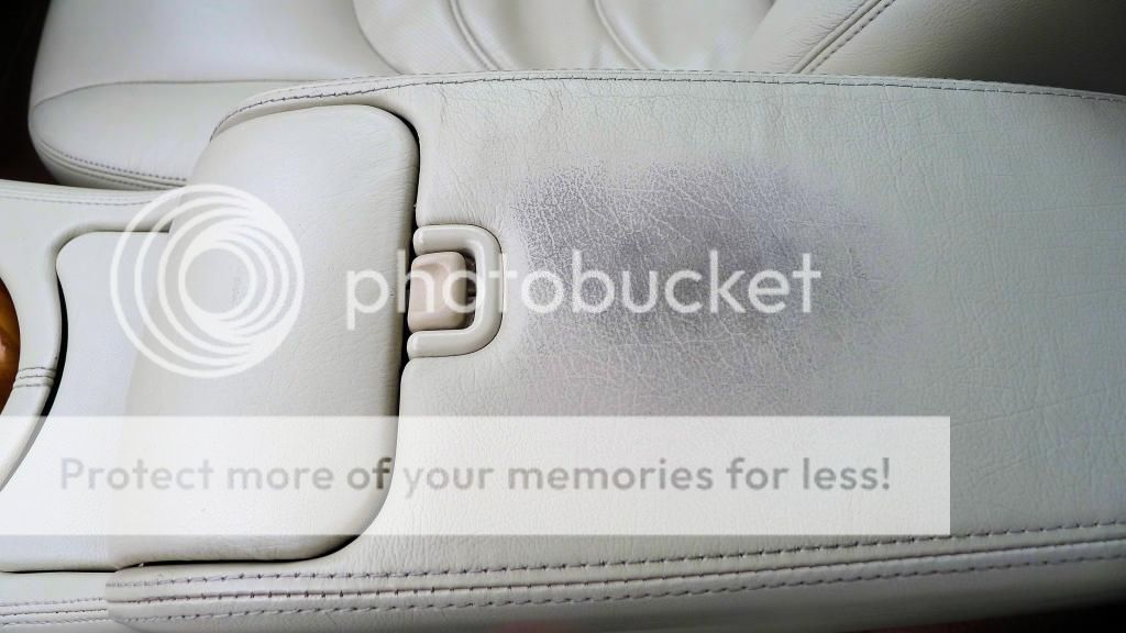

    Been working on the leather. Gave them a good clean and conditioning. However as expected on a car of this age, 2003, there is wear. But I have been working on it as these before/after photos will show.
    Not quite finished yet. There are still some lines to get rid of but that will have to wait till summer. The seats look lighter and cleaner now too. The other item with the quite visible difference is the arm rest. Again I will have to colour wash it because the good bits before and now looking a bit shabby in comparison to the just done stuff. What do you think? Looks better doesn't it.

    Hi Frank, that's very impressive. I especially like how your leather has come up. In your 'before' pic you appear to have lost some of the leather surface on the seat side panel. On your 'after' pic it appears cured. I have a similar worn patch on mine and have cleaned and conditioned using Furniture Clinic's products with excellent results but the mark still shows. Did you use anything else? If so, what was it and if not, what cleaner & conditioner did you use please?

    Over the years I have tried many products. The furniture clinics products I am sure are good but far too involved for me. I used Scuffmaster from Gliptone, just google Gliptone. It has the finish and other stuff all incorporated into one product. You simply get a little of the product onto a tiny sponge, supplied, then dab it into the creases. Letting each layer dry for around 20 mins. On really bad stuff you can sandpaper the worst out then use the stuff I mention. Their conditioner and cleaner are very good too and give a lovely leather smell. Their customer relations are cr** but the product is good. I once bought a 1 litre bottle from them to do some seats. The bottle arrived spit and half of it lost. I emailed them but they were just not interested. If it were not such a good product id tell them where to stick it.......... but I am not going to cut off my nose to spite my face
    Carpets should be dry by now...... yes carpets 90% there. Posted after picture above.
    Oh and the armrest. That was not dirt. It was worn off. So again the scuffmaster stuff re-coloured/painted it. Before you cringe at the word "paint" as far as I know all leather seats are "painted"
