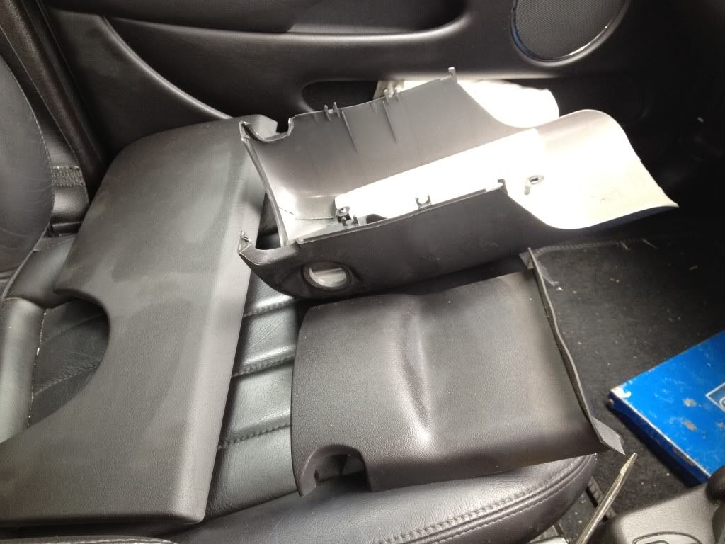

In response to Big cat little cat's excellent instructions and success, I wanted to change my cruise control switch panel; my wheel switch rubber had worn, although the cruise still worked fine. Here is how I did it:
Firstly, remove the panel below the steering wheel, by your knees, by simply pulling it off. The top and bottom steering column shrouds are held together by 3 screws, a T20 driver is required.
I then unscrewed the 4 screws holding the rear of the steering wheel on. Again T20 driver is required.
