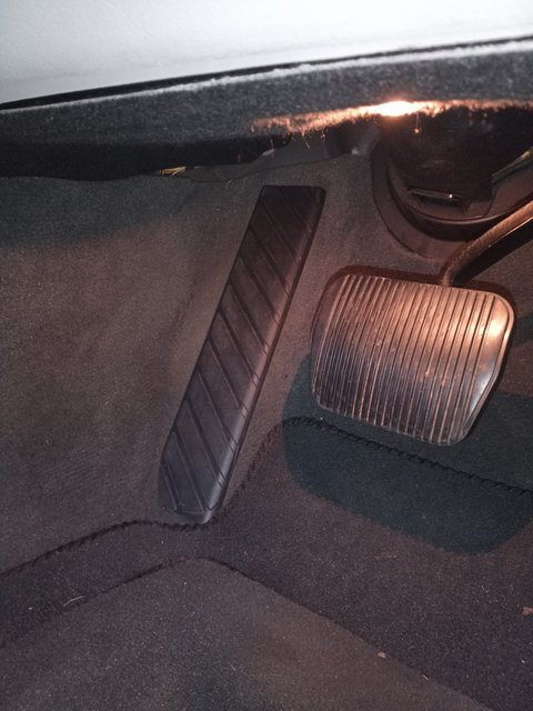

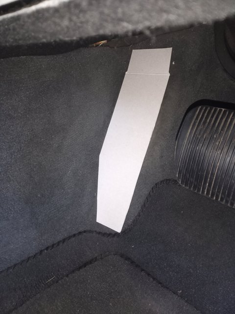

My latest modification has been to create a footrest for my left foot. The carpet was beginning to look a bit worn:
Bit of CAD:
One modified Audi A2 footrest later:

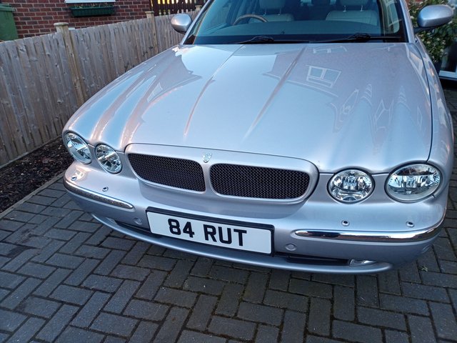

Here's the resprayed grille in gunmetal, which just highlights the mesh ever-so-slightly (black made it disappear, and as its not a supercharged one, I don't want to be accused of mis-badging with the stainless steel version):
Bit of CAD:
