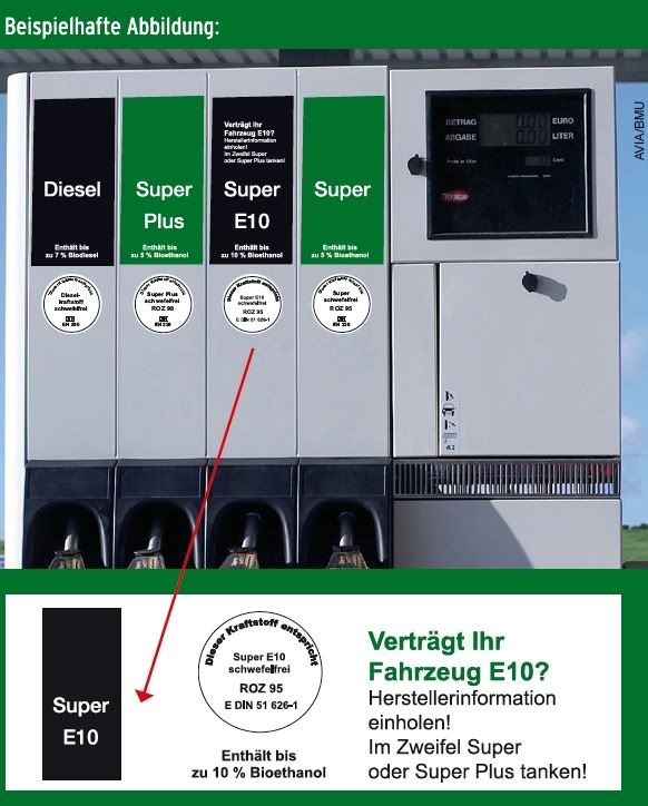

At least in Germany we have an E10 95 petrol and super 95 petrol containing no ethanol, which is what I use. As in the handbook it says don't use a petrol containing more than 7% ethanol.
As something slightly off topic that is a concern as within the next couple of years the plan is that all petrol sold in Europe will have 10% ethanol. What age engine does that relate to?

... in the handbook it says don't use a petrol containing more than 7% ethanol.
My 2004.5 XKR handbook says petrol containing up to 10% ethanol may be used.
"At least in Germany we have an E10 95 petrol and super 95 petrol containing no ethanol,"
What makes you think that ? E10 by definition is 10% Biofuel , usually Ethanol. Quick internet search says Germany had moved to E10 by April 2011 and that 93% of cars would have no problems, shame about the other 3 million cars though !
What makes me think that? I live here and says it on the pump!
Well Ian you must be right ! Just that by definition the E in E10 stands for Ethanol, all the web searches say Germany has E10 containing 10% Ethanol.
