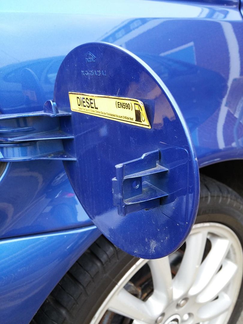

Im looking for some advise. Im a new comer to the world of Jaguar and bought my first one 2 days ago. It really is a thing of beauty and really pleased with it.

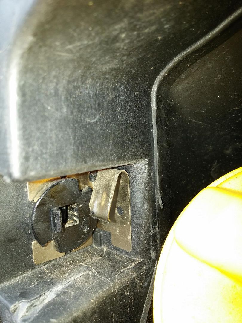

I do have a small problem though, the fuel flap does not lock closed. I have a couple of photos of the door flap and another of the locking mechanism (links below)

Hiya, sadly pushing it back into position won't help, the co-axial spring has broken up and it'll go again next time you pull the lever. With a bit of a tug you can pull it out from the inside of the car, and replace the spring, unless of course the cable has broken. (unlikely) Good luck, let us know how you get on. Martin.

Its raining here so u havent been back out to try accessing it from the boot. I did notice however with Martin mentioning the spring. If i push the black catch which is in the black square recess its pushs in maybe 1cm and if i then remove the pilers is springs back. Is that the spring you were talking about martin?

Saw this thread and thought I would take a look at mine so I removed the wheel arch carpet in the boot you will see the cable I was able to grab it with my right hand and pull the cable out of the hole and I replaced the spring with a stronger one but the hard thing is getting it back in the hole as it is a square hole so keep turning the plastic latch until it slips in and job done
