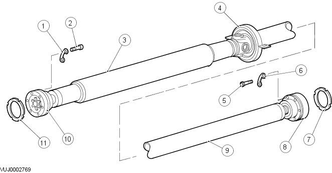

It now looks as though the knocking is actually a very worn bearing at the front of the prop shaft, just as it comes off of the gear box. I asked him to find a price for a replacement bearing, so he phoned around and he was told that the whole shaft needs changing, you cant just buy the bearing anymore as its been modified to fix this problem. The price quoted was £300+VAT which I could do without at the moment.
So my question is this, can replacement bearings be sourced from anywhere or am I going to need to pay a visit to a breakers to get one?

If you mean the central support doughnut, i'm aware the whole prop has to be changed, but, i believe if it went in it can come off, and be renewed without having to replace the whole prop and the bearings changed. The prop should separate one way or another.
Ryan
I've not heard of this part failing before, doesn't mean it cant happen tho. Like i said it was put together somehow so that means it must be able to come off, guessing its on a spline, although its getting the part available separately which could be the difficult part. Try calling your local jag dealer to see if this can be sold separately, failing that, a local scrap yard may be able to help.
