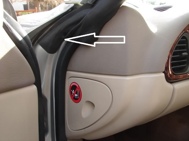

I have a 2004 XKR coupe which is suffering from a leaking door seal on the driver's side of the car. The seal in the door itself has been replaced but the water appears to be now getting past the front of the seal around the door opening, towards the bottom of the A pillar. It then runs down the side of the instrument console and accumulates in the footwell. Has anyone else suffered from this issue and if so what is the fix? Replacing the complete seal around the door opening is very expensive and I need to be sure that it will cure the problem before pressing the £££s button!

Yes, many suffer this. I have a pic somewhere of the offending location.
This is the nearside view.
Thanks for the picture Inditime. Yes, you are correct, that is exactly where the leak is coming from. I took the car to a garage in Coventry some months ago and they tried to fix the leak path with sealant but to no avail. Do you think replacing that seal will definitely sort the problem or is there still a potential leak path behind the seal from the roof gutter? The reason I didn't get it replaced before was the expense of a new part.
Thank you astromorg ...... I've had a quick look at the link and it certainly looks like a possible explanation of what's happening. I'll investigate a bit further and let you know what I find.
I took my XKR to Elite & Performance Jaguar yesterday and they think that the leak is behind the rubber seal around the door aperture. They think that the seal has been removed at some point and the foam backing near the bottom of the A post damaged. Essentially these are one shot seals so if any remedial body work is carried out behind the seal then it should be replaced. I don't understand why the cost of these seals from Jaguar is so astronomical , their mark up must be exceptionally high! That is one real issue with owning these high performance Jags, they are generally very good value to buy but very very costly if even the simplest things go wrong. Everything on a modern Jag seems particularly and maybe unnecessarily complicated. Why does the form of a door seal need to be so intricate???????
New aperture seal fitted and no sign of leak anymore but soooooooooooooo expensive to fix. The door seal and aperture seal together, with VAT, were over £550 just for the parts. On this basis I hold Jaguar in the same regard as bankers when it comes to ripping their customers off. Very disappointing!!!!!!!!
