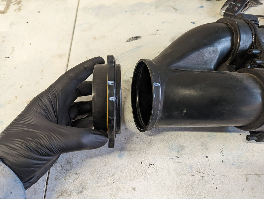

First up, and my priority, was the air box. Here's what I'm dealing with:
I stuck it back together with this:
It seemed to stick well, though was slightly tacky still when I reinstalled it so I won't know for sure until it's fully cured.
On reinstall, I also took steps to prevent it breaking again. It looks like a previous owner tried the quick approach to air filter replacement where you just lift the outer edge of the air box lid. The stress broke the pipework.
The problem is that you need to lift the front edge really high to disengage the rear clips. What I've done is file down the clips. I reckon I took 2 or 3mm off the bottom of the two outer clips. You now have to only lift the front of the lid but about an inch, then it'll slide off the clips with a little wiggle, and provide easy access to the filter.
Here's where I filed it. Hopefully you can see what I mean.
