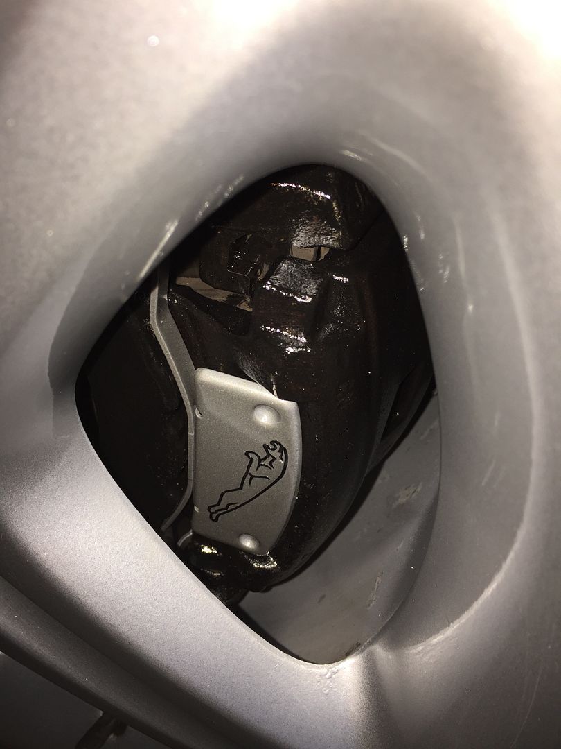

Caliper refurb Part 1
New car, new tools required ;)
Purchased the following,
  • A low profile trolley jack and 2 axle stands from SGS Engineering
  • A 120 piece Advanced Professional Halfords socket set, currently 50% off all sets
For the refurb,
  • Brake cleaner
  • Hammerite Smooth Black paint
  • Half inch brush
  • Clear VHT lacquer
Come May next year I'll be having the discs and pads replaced/upgraded to all 4 hubs and I have already been investigating options available.
I have identified that my front discs are 355mm diameter part No C2C25337 and the callipers are made by ATE. The caliper springs are part No C2P17596 and the Jaguar logo's on mine are just about unreadable. New are nearly £80 each at DMG so a quick search found a second hand pair for £20 delivered.
The rear discs are 326mm diameter and have calipers with a logo plate held on by 2 M5 x 12mm Torx screws, easy to remove and leave off.
So I have refurbished the four logo plates/springs using high temperature paint and high temperature vinyl logo's, overcoating them with high temperature lacquer.
I had the logo's made at http://www.ccdecals.com/
Here they are ready to go on the car when the calipers have been done,

Caliper refurb Part 2
Last week the plan was to use my brothers level drive to park the Super up and get the calipers done a side at a time, his 7.5 ton truck parked up having its tail lift replaced kiboshed that plan.
So on Tuesday I set to and began doing a corner at a time on my not so level drive, I used wheel chocks that come with the Discovery tool kit.
Here's a photo of one of the calipers, clearly showing the need for doing them,
My only intention was to smarten them up so I opted for painting them black and use a paint brush.
I managed to get the 2 rears and 1 front done before the light faded on me and then had to wait whilst Friday afternoon before the rains departed and I could complete the job.
I'm very pleased with the outcome and it wasn't too hard a job to do :-D
120 miles covered over the weekend, washed Monday and they look as if they'll survive awhile.
