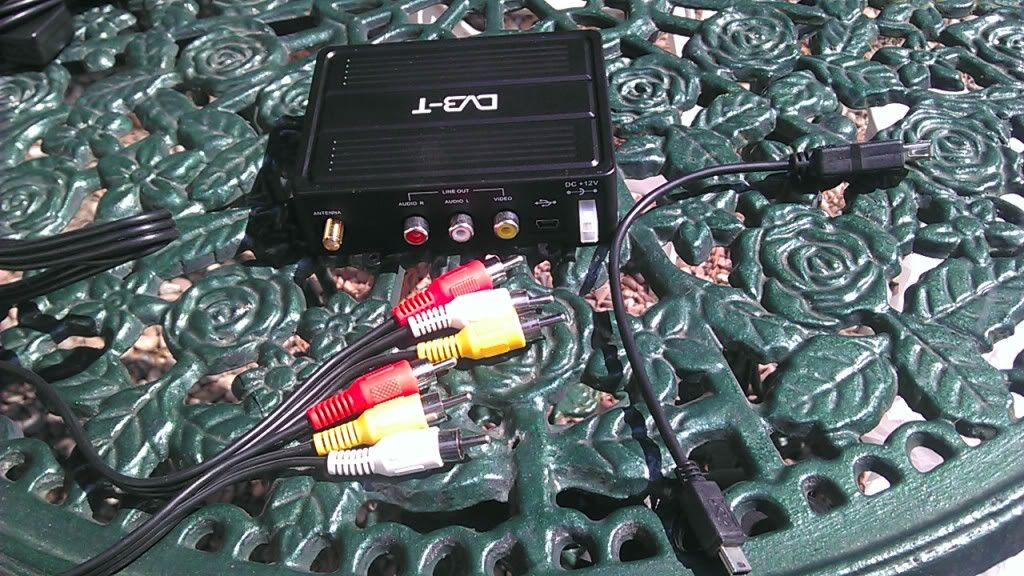

I have been given a TV module with associated leads and would appreciate anyones opinion as to whether these leads will enable me to install TV into my S Type.It has navigation, b/tooth and voice but I don't know if the screen is compatable for TV or even if it's a colour screen to begin with.
I have posted a pic of the module and wires.
Thanks
1 - 3 of 3 Posts
You need a Video Interface to bring the image to the screen like this one The New NavRGB 2.0 interface
And then you need an ACM, to bring the sound into the head unit http://www.jaguarforum.co.uk/f25/audio-connectivity-module-acm-faq%92s-tips-tricks-39352.html
Thank you for that. At $350 I'll stick to watching TV on my smartphone :)
