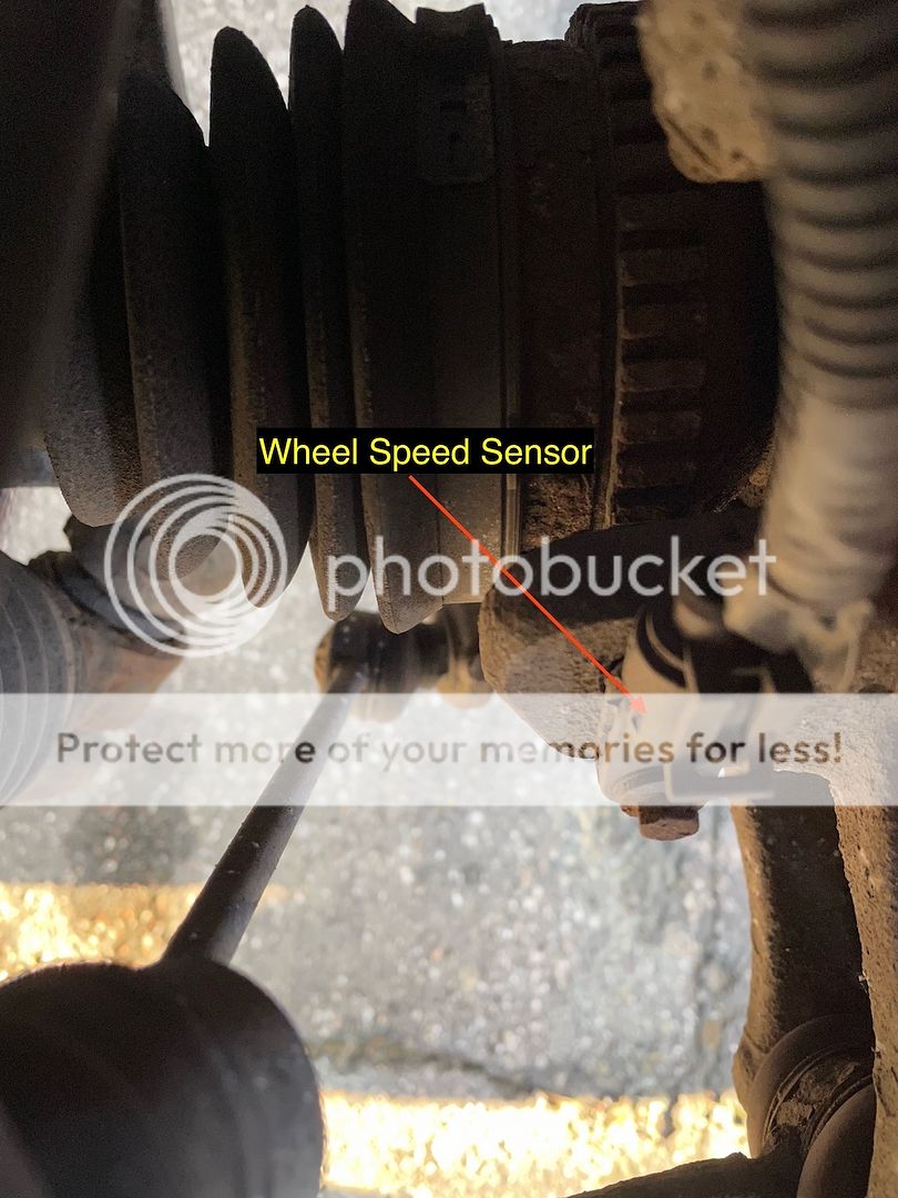

I’m not sure if any of this will help (others), but this was my experience/s with the X350:-
‘DSC not available’ was not unexpected if the car had remained unused for some time, and the battery had naturally dropped in bit while standing. This always resolved itself quickly in terms of the light going out immediately on start up, and remaining out with a bit of use.
I then had an occasion of the ABS light coming on, and this then threw up other warnings such as ‘Gearbox fault’ - as a result of the fault with the ABS sensor/ reluctor ring.
Ahanti’s helpful photo appears to show a toothed wheel type of reluctor ring, but mine ( and others X350s I’ve seen) had thin ‘window’ rings shrunk onto the drive shafts. These result in three possible issues:- first the shaft rusts and expands the flimsy rings, which in turn make contact with the actual ABS sensor and stops the sensor functioning. The third and equally affecting issue is that the shaft also forms rust within the areas of the reluctor ring ‘windows’, so even a good sensor cannot sense the ‘gaps’ properly.
New rings can be bought - at about £60 each from Reluctor Rings Ltd., but I found the X350 could have been fitted with a number of different sizes - complicated by these differences being very marginal, but important. Way forward - take the shafts off and send them off to Reluctor rings for them to shrink new ones onto your shafts. Problem- car has to sit over someone’s pit or on hoist for about a week.
What I did with mine was to spend a couple of hours each side and carefully clean out every window segment, then fit new sensors ( I used Febi ones), but spaced these sensors further away from the rings by packing them out with a 1 mm thick, 8mm hole dia., stainless washer. Job done!
