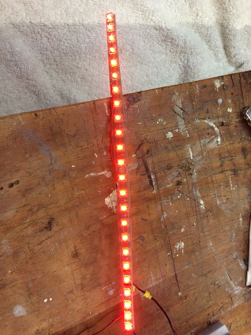

I have read on the American forums that a re-boot has cured a high level brake light so it gave me a slight dilemma to consider. However, I took the light right out this morning, cut off the plug and connected the lamp to a fully charged 12v battery on my bench and .................nothing.
New bulb ordered for a stupid price of ÂŁ69.50 plus VAT.

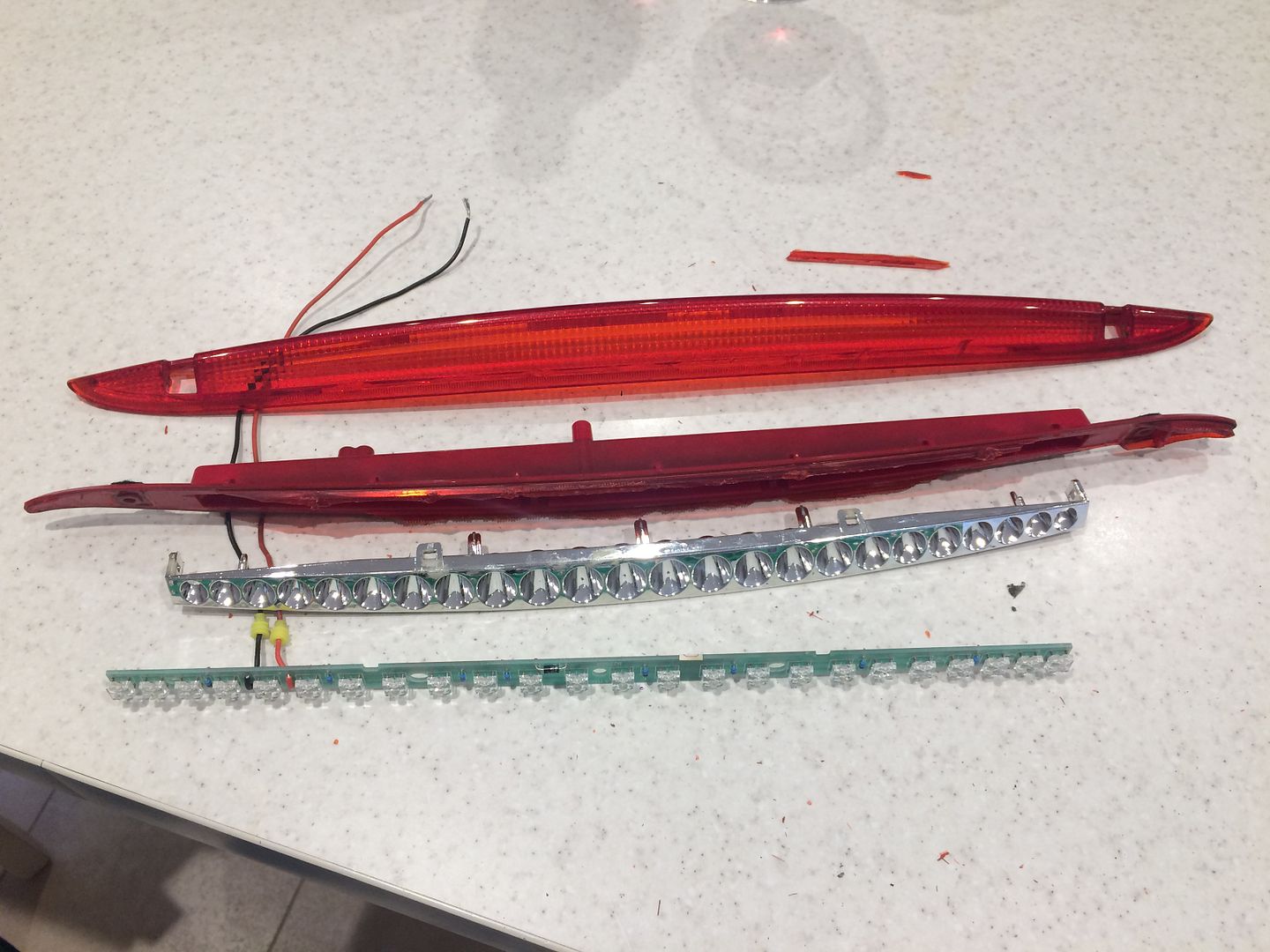

Part arrived, fitted and it works. However, it doesn't seem to be a brilliant fit, but then the old one wasn't either!
Having fitted the new one I decided to carefully take the old one apart and found that a 99p diode has failed. When the replacement arrives, just for something to do, I shall solder it onto the small motherboard and see if the repair works.

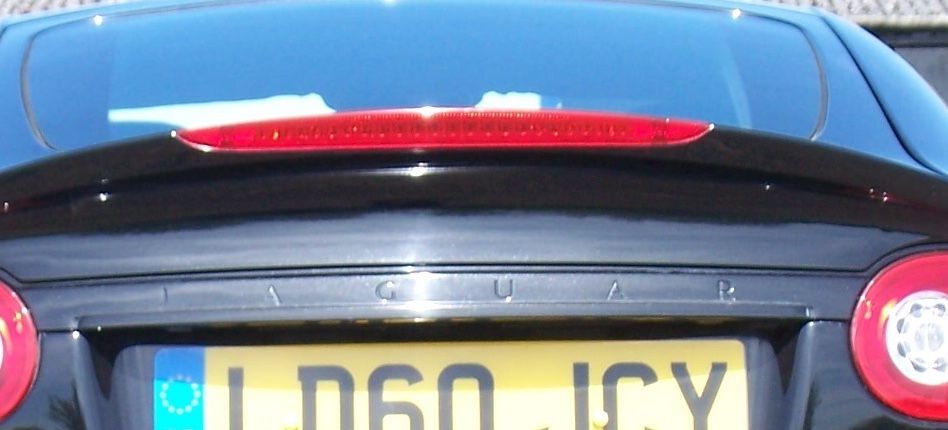

Part arrived, fitted and it works. However, it doesn't seem to be a brilliant fit, but then the old one wasn't either!.
When you say not a brilliant fit, do you mean the centre is not flush with the boot lid/lip, like it is under tension? I noticed this the other day and wondered if it was due to the colder weather; I'm sure it looked a better fit before!

Anyone else seen this issue?
In October when I got the car the LED boot light strip fitted closely, yet now at the centre it is a couple of mm out, not massively, but noticeable when you stand to open the boot.
Could it be due to winter temperature?

I spent ages trying to get the lamp to fit perfectly then assumed it was just a poor fit.

The HLSL on my old Black beast with the larger spoiler looks the same size.
Interesting point though as the curvature is definitely different.
Gap on my new lamp is 2-3mm. I also just checked a 2007 25k miler and that has the same gap, so I assume the poor fit is standard.

I don't recall the lamp on my old car with standard/lower spoiler seeming like a poor fit, but perhaps I never examined it that closely. The one on my new car with the taller spoiler does appear to be fine to me.
Didn't the 4.2 X150 convertibles all get the taller spoiler as standard? Perhaps they shaped the lamp to fit the taller curve and just "made do" with it on the smaller shape.

All done now. It turned out that the diode was working OK but a fault had developed on the PCB resolved by adding a small piece of wire.
Photo of the various components which were superglued together. This is probably why the problem occurred as water must have entered. Silicone would have made a better seal.

I had a good look at the high-level brake lamp when washing the car last weekend, mine seems to fit pretty neatly? It's slightly recessed from the main curve of the spoiler but in a way that appears to me to be by design rather than poor design or manufacturing quality.
Perhaps the supplier was changed after a certain point in the production run (or after production altogether) and the ones being supplied now are not quite the same shape and size as originally designed?
